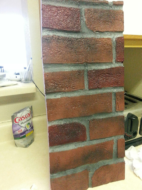

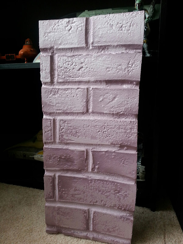

k, started practicing making brick walls...........
First pic is plain pink foam with the carving, I did a little more carving on it before I painted it...

Great colors on the bricks.
Re: working on a new chiller........
That's amazing. That's Hollywood FX quality right there. How do you get the texture like that on the bricks?
Thanks Mac and Andy,
Mac, after you grind out and sand the grout lines you spray water onto the "bricks" and wipe it with your hands to break up the beads of water, then use a heat gun (on sale now at Harbor Freight) and just hold the gun over the bricks until they start to deform and then move to another part of the brick until you get the look you like.

That's awesome Spooky! Think you can cover the whole outside of my house with that. I love the look of brick houses but we're not allowed to here.

Do you use a dremmel or some other type of rotary tool for grinding?

Mac, I use a dremel to get the lines started then I used a small wire brush to "dig" them out the the proper size and depth, the brush gives it that "tooled cement" look to the grout.
